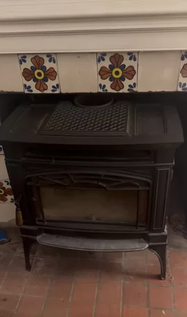

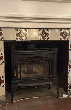

There are some red flags with cutting the legs. That is going to lower the firebox which will increase the hearth protection requirements. The stove radiates heat out from the front door. It needs 16" of hearth protection in front of the stove door, with the uncut legs. It's unknown when lowering it. The setup in post #28 looked better and safer, especially with the wood mantel above the stove.
The photo from post 28 is included. Yes the door radiates heat I agree. But it’s designed to radiate from the top as well as I held a piece of tissue paper over the top and the paper blows directly up. And the Lopi have multiple videos describing their designed convection air flow from the stove bottom out through the top.
First photo is the post 28 you referenced. Second photo is what I’d like to do as the top isn’t completely covered under the firebox lintel
Wouldn’t the stove radiate more heat if more of the top and sides were exposed instead of being fully inside the firebox?
What about the heat from the stove top being trapped under the lintel?

Paper going up is not radiative but is heat shed by convection.
A stove in a fireplace should have a blower to get the heat out of there.
Cutting legs will void the certification with required clearances.
I’m super ok voiding the certification.
Radiating/convection apples and oranges, exactly the reason I don’t want the stove to be too far into the fireplace firebox. I want it out into the room to radiate/convect its heat into the room and the rest of the house.
Your ok with voiding the certificate, but just remember that if something were to go wrong your insurance company would not be ok with voiding the certificate and that would be grounds for denying a claim.

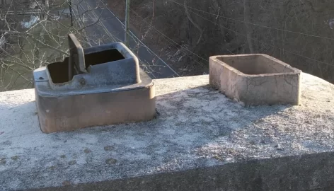

and picture included, any advice on removing the existing self sealing flue damper, im sure there is some adhesive and I don't want to break the terracotta

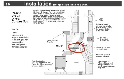

So my insulated chimney lines won’t be here for another 10 days due to back order. Have a huge cold snap coming this weekend so I went and bought (2) 24” 6” stove pipes and plan on doing this temporary connection.
In the image the red circle I’m asking what should I use around the stove pipe at the damper as insulation not to let cold come in?
I see rock wool is used but just asking to make sure.

rockwool is good. Make sure it's not glass fiber.
