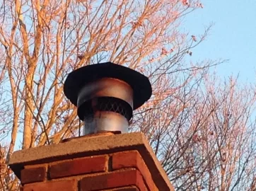

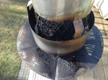

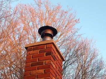

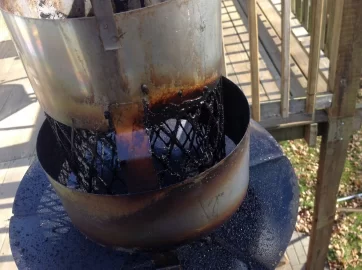

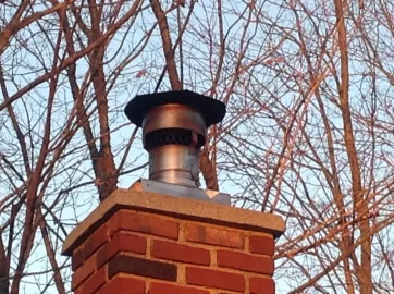

[Hearth.com] A bit paranoid, but...what does a rain cap/spark arrestor look like post Flue Fire? [Hearth.com] A bit paranoid, but...what does a rain cap/spark arrestor look like post Flue Fire? [Hearth.com] A bit paranoid, but...what does a rain cap/spark arrestor look like post Flue Fire? Looking at it in the daylight, it seems all is probably well. I would imagine if there had been an issue, there would be warpage or burnout of the screen. Still need to look down the hole though.

I see yours also has the bluing (rainbow) effect on the steel. It was my impression that this came from the steel being super heated, which I don't think would normally occur at the top of the flue?? I have nothing stuffed around either end. No T, just a straight shot up from the top of stove.

I have that rainbow effect also and some shinny stuff. I went up there and the rainbow stuff just wipes off so i guess its not from extreme heat like we would think!

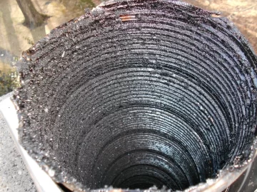

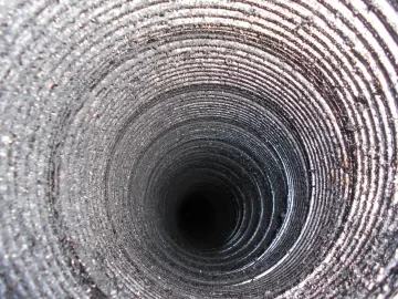

Here's what I found... Everything was flakey, shiny and flakes right off. This is the top of a 20 foot flue liner.

Looks pretty normal for early in the season. How much wood has gone by that flue since the last cleaning?
If you want to keep the build up down, let the first fire of the day get the flue hotter for about 30 minutes.
Reactions: RockyMtnHigh
Cleaner than mine has been in six years.
Burn on.
I would say roughly 2 cords since last. So is it safe to say there is no sign of any damage/fire in the flue?
Looks clean enough that I would not think a fire is possible.

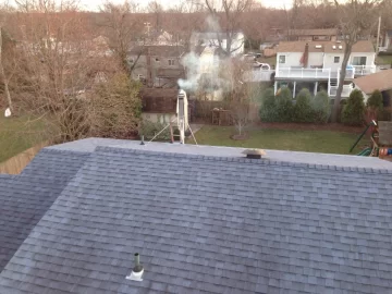

Heres mine with an arial view from the bucket! Lol just threw in some splits hence the smoke! I know hard to see but its cool up in the air!
I agree with rick B there is nothing to burn there!
