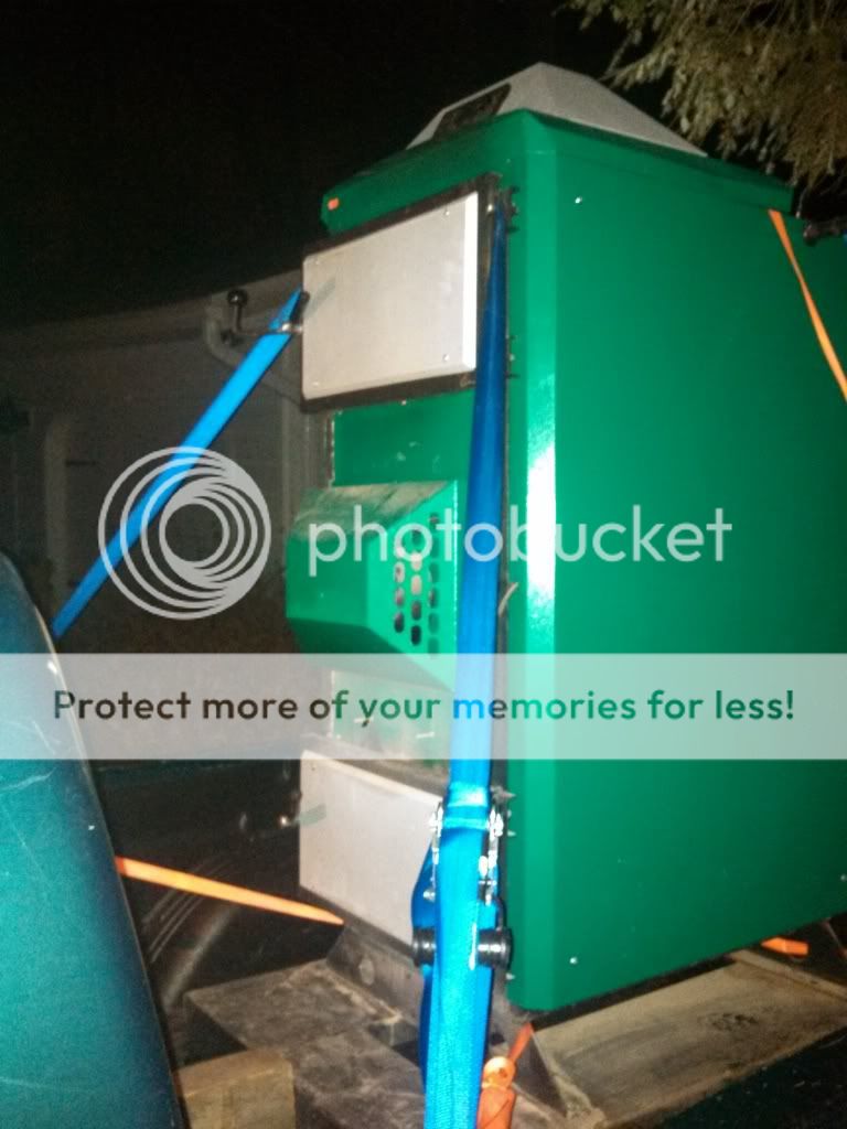

Well my wallet is $2500 lighter, my truck 1300 lbs heavier, and I am the new owner of an EKO 40 Super. It has the RK-2001UA controller and came with a Danfoss valve, expansion tank and a bunch of 1 1/2" black iron fittings, nipples and valves.

Now I need to find someone to weld me up some pallet forks for the tractor so I can get it out of the truck...

I don't know the difference in weight from the 40 to the 25 but I was in a confined space between my detached garage and the roll up door in my basement so maneuvering a tractor was close to impossible.
I see yours is still on the original steel pallet which makes it very stable. I backed the F-150 up within 12 feet of the door, let the air out of the rear tires, removed everything that I could from the boiler to lighten it up and slid it down some planks. I then levered it up on some 3/4 inch plastic pipes and drove it to it's destination. I wasn't able to get any help that day so I did this all by my lonesome.
Once it's up on rollers it can be moved anywhere.
Forgot it also came with a Taco 0010Fsomething circulator.
I put a tee on the boiler outlet and lifted it out of my truck with a chain block.
I had not considered that... no concerns with all the weight on those threads? Yours survived so that is at least one data point.
I don't know the difference in weight from the 40 to the 25 but I was in a confined space between my detached garage and the roll up door in my basement so maneuvering a tractor was close to impossible. I see yours is still on the original steel pallet which makes it very stable. I backed the F-150 up within 12 feet of the door, let the air out of the rear tires, removed everything that I could from the boiler to lighten it up and slid it down some planks. I then levered it up on some 3/4 inch plastic pipes and drove it to it's destination. I wasn't able to get any help that day so I did this all by my lonesome.
It needs to make it off the truck and then down a few stairs and through the basement door. I was going to build a temporary ramp up the stairs and the slowly lower it down to the basement, then roll it across the floor with pipes. I used planks and a handtruck to roll the Jotul F55 off the pickup, but that was only a few hundred pounds and the planks were looking pretty unhappy.
