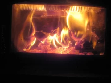

What makes a "good burn". I just got this stove insert for my fire place and would like to know if I'm using it properly.
At night (last night's picture attached 10pm) I'll get it burning good and hot. When I took this picture, the thermo on the top of the stove (middle, by the bypass lever) was about 650 degrees. This morning at 7 when I checked to re-light, the fan had just turned off (turned back on w/in 5 min of fire starting). Usually I'll closed the air down before it gets that hot, but I was a bit distracted last night. Overnight burn has the air totally shut off.
So, I'm getting 8-9 hours on an overnight load w/ hot coals to re-light w/o a problem.
During the day, I'll re-light at 7-ish, then by noon I put in another load (I work from home). At this point before I re-load, I've pulled the coals forward a few times, and have the air wide open. Another load probably around 4pm, then 10.
I'm a wimp, and I like it warm. Unfortunately, my office is as far from the stove as I can get on the main floor of my house. Upstairs (cathedral ceiling w/ an opening to the hallway) is cozy. 2400 sq ft colonial. I need to figure out how to get the air moving back to my office!
So, what's a "good burn" and does my burning schedule seem OK? Also note that the secondary tubes are starting to glow in the attached picture. Is this OK or too hot?

A good burn is one that meets your needs. Sounds like yours is meeting your demands just fine. I could get away w/ a smaller stove at my house, but opted for the larger one for the longer burn times. Sometimes this means we are opening a window and burn more wood than necessary, but at least I don't come home to a cold house and have to relight the stove while I am trying to get dinner on.
Everyone has different criteria. I say if you are happy, the fire is hot and clean keeping the chimney clean, and you are running the stove safely, then you are doing a fine job.

650 is on the high end of the range I burn in. I'm usually in the 550 range, although, if I really load it up (like this morning) it'll get up towards 650.
From the pic you posted, it looks like your stove is burning just fine!

That's the same fire box as my Endeavor, and that pic looks like a fine burn to me! Sounds like you're doing just fine.

It is my understanding that glowing re burn tubes is ok as long as nothing else is. I am starting to get used to how mine works...still frustrating at times when it sits happily idling along at 600 for an hour and then shots to 750 -800!
