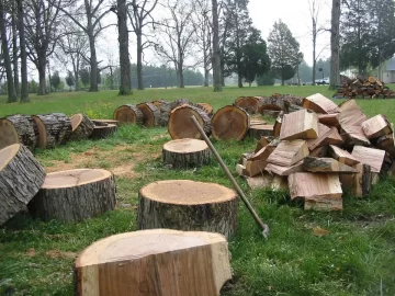

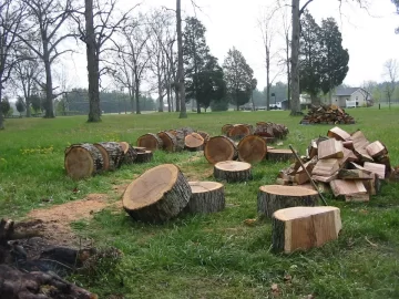

I just recently introduced my friend Tim to this site he's hooked,he bucked this monster this weekend ,and it should be ready this fall,tree has been down for 2 years.

Thats a nice one. Iam still working on one myself.
Love the White! ==c Smells so good.
He might be surprised at how wet that wood still is though. You've got a meter, don't you?
That is a monster, but I wouldn't count on it for next year. Those big Oaks hold a ton of moisture until they are split.
Reactions: ScotO
They appear to have been cut very small. Perhaps this was to hasten the drying?
The rounds look small but those splits look huge, maybe its just the picture. I'm with flatbed with this one too. I think you'll be surprised with the moisture.
ohlongarm, that is a nice size tree but I'm with the rest when they say it might be to wet for burning for the 2012-13 season.

Don't know why but sometimes the dead and down for x amount years seam to have as much, or more moisture than a live one.
The drying clock starts once split and stacked. (usually, especially with Oak)

In reference to all the comments made above on the oak tree I took down, I have been cutting all my wood in late spring early summer and burning it the same winter. What I have seen here and learned here is that the consensus is that oak takes two years to dry. I need a new game plan. I cut those rounds about 12 inches so I could hand split them. I thought they would be ready this winter. Since visiting here, I have put all of this wood on pallets and stacked. I had been throwing it under a lean to with open sides in a large pile. I really had no problems to speak of though, although I did have enough creasote built up. I went out last night and cut myself 30 big rounds again. After getting into it I realized it was again a piece of red oak. Need to collect some wood ready this winter and save this oak for the following year if I can. How about Shagbark hickory.............if I get it now will it be good for the winter ? or at least alot better than the oak

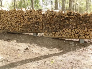

It will be alot better- first winter I burned 6 month cut/split/stacked Oak, You just have to work on it and get farther ahead than just cut in spring and burn that winter, all wood takes longer than that to dry. Oak just takes the longest. Single rows stacked in the wind and sun will dry fastest. It is alot of work to get ahead.
Good Luck and Welcome
