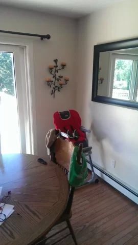

This brings in another option. If I do a corner install in my kitchen and vent it out the side of my house, the appliance could be bigger, the house would heat more evenly, and it would be out of the way for safety's sake with my baby. Only downside is I'd have to cut a hole in the side of my house. :)

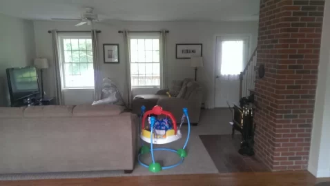

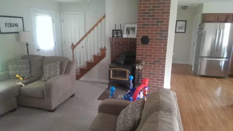

I am limited in depth of the stove in terms of protruding into our walkway. Here's some pics of the F1100 and where I am considering placing it. Im a newb here
so hopefully this works......
edit: 1800ish sq foot cape from 1997. original doors/windows

After looking at the pics, if you move it further away from the stairs, it will be harder to heat the 2nd floor unless there are heat registers in the ceiling/floor. Can you put in the larger unit where the F1100 is currently? The do sell some fence type gating that you can put close to but around the stove to keep the baby away. Just my 2 cents.
Thanks for the pics:) nice looking home . Helps me to see what you are thinking about doing. Replace wood stove with a pellet stove. My 1st thought is go listen to the stoves you're considering, pellet stoves make noise some more than others. They got motors & blowers and this is your TV & dining area.

Interesting. I figured the blower of the bigger stove would blow the heat more evenly around the floor and it would subsequently heat the upstairs better? I figured the SF would blow into my living room area and have a harder time getting into the kitchen area and upstairs.
There's just no room over there for a big stove. The pics are deceiving a little bit but I dont want to be stepping around a huge stove all the time :)

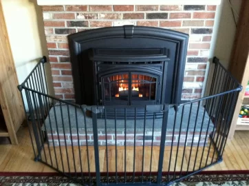

A hearth gate might work for you. I have a 3 year old and a 1 year old. The gate works great. It's adjustable too, so it shouldn't block your stairs too much.
