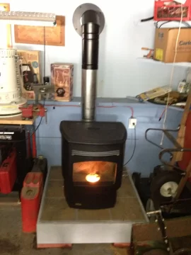

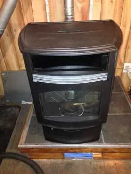

I had 2 Quad Santa Fe stoves and they really belted out the heat! Talk about efficient, they were pellet misers! Sorry to see them go, but I replaced the Santa Fe in the shed with a Quad Contour. Same stove except it has the pie warmer compartment to keep my coffee mug warm! LOL The Santa Fe in the garage was replaced with a Harman P61, now a P61a. LOL
