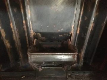

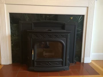

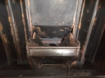

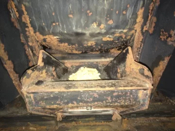

So I went and got the stove today. Not the easiest job getting it out. I couldn't get the stove to slide out of the frame that sits in the fireplace. I was kinda expecting that frame to be screwed in place or something but not the case.it came right out with the stove itself. removed the 4 screws holding down the top and also had a difficult time removing it but finally got it out. So I got all the cast off which did make it a lot easier to transport. I have it in my shed now and will begin to go thru it over the next few days. I tried it in test mode and all light are on on control board. Both blowers work fine. Igniter is good. I have a red light for the feed motor but the auger will not turn. Stove was installed new in 2005 and used for 2 seasons. The couple I bought it from have never run it so it had been sitting there for 10 years unused.hopper was empty but I think there may be some pellets in the feeder system which may have gunned up the auger which is why it won't move. Just guessing on that though. This stove is in very good condition other than some interior rust but nothing that a little elbow grease won't fix. Can anyone tell me how to gain access to the distribution blower. Pics to follow soon

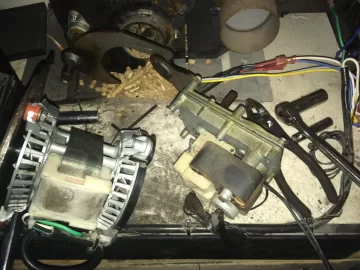

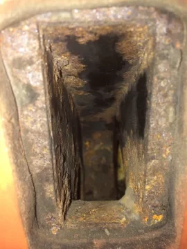

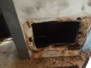

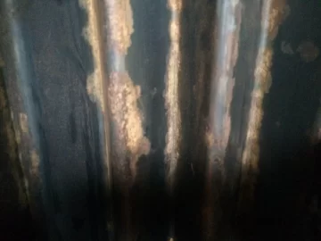

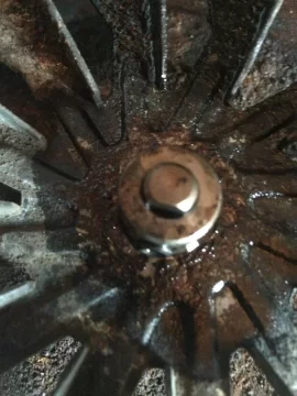

So I got a chance to look at the stove today. I put it in test mode and again had all lights red on the control board.however the only thing that was actually running was the distribution blower. I had a feeling the feed mechanism might be jammed up with pellets so I pulled the auger motor and the auger. To my surprise it was clean as s whistle. Had some pellets in there but the auger is like shiny new and motor runs great on my test cord. I opened up the fines box and all good there too. Since this unit had been sitting fo about 8 yrs I opened up the gear box and added some high temp grease. So next I tackled he combustion blower snd what a disaster that was. I've been soaking the wing nuts everyday since I got the stove on Tuesday. I went to remove the blower and 2 of the wing nuts snapped right off The stove body and all the cast is in crazy good shape as is the rear of the stove where all the components are. The inside of the stove has some minor rust that I was able to sand out but the combustion path and blower housing has some serious rust. I had a heck of a time getting the blower out but eventually did but now I have 2 of the screws stuck in the housing.i did get s lot of the rust in the housing and need to get a long brush to tacks the exhaust path next. And tips on how to get those 2 screws out.

Did you put the hopper lid back on? If that lid is off or open the feed motor will not start. Does the comb. motor turn freely. The vac switch has to close for the auger and the igniter to start. vac switch opens and closes the neutral to those 2 items. That is why you get the light even if it does not come on.
Yes the hopper lid is back on as is the door. My mechanic drilled out those 2studs and last night I installed the auger motor and combustion blower with a new fan blade. Just about ready to be fired up if the weather cooperates. It's in my shed so I gotta pull it outside once I get a chance to burn
