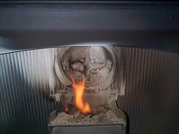

On page 19 of the Harman Accentra Pellet Insert manual on the left side of the page last two paragraphs where it has the wod required it shows a definite relationship between draft and voltage. Indicating less draft with higher voltage. IMO.
I have tried different settings on that control to no avail. The person that was here looked at the draft test adaptor and said hmmm.
The setup here is straight out the wall to a clean-out T then vertical three feet to a dryer vent style cap.
On the second visit the store rep set the draft with the meter reading half, at rest. I asked isn't there a zero adjust on that meter? He replied no. So my draft has never been really set to anything. The ash is grey and in the shape of pellets.

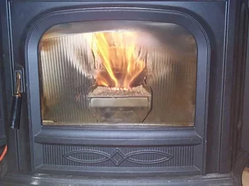

I have cleaned this unit according to directions two times. What I am finding is the result of whatever is wrong with this unit. Not finding the cause.

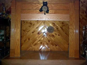

The $400.00 hole refers to what I will be left with when they remove the stove simply because they don't know what is wrong with it. The stove is placed in a wooden fireplace enclosure. (fake fireplace) straight out through the wall. With a 4" pipe through a thimble.

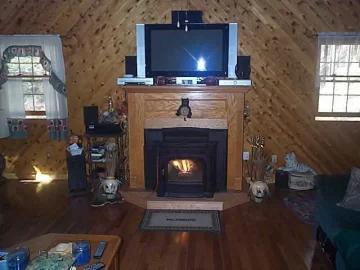

PS: The medalion picture is after two weeks of use. Click on it to see. The hopper door is open to enhance the view of the fire.

Yes I removed the baffle plates and run the wire brush up the two tubes. The space under the firepot was half full of ash at the two square holes at the back. But all this is not what's wrong it is a result of what's wrong.

I keep a hammer and a one inch chisel on my dining room table to clean off the unburnt fuel from the burn pot every four hours.

I was going to show before and after scraping but knowing they were coming I only have the before pictures.
I'll let the pictures speak for themselves.

Update, this is a picture of my so called $400.00 hole.
