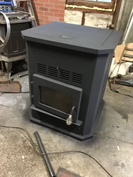

Hi all, new here. Looking forward to learning a lot! I searched the forum for my answer, but couldn't find anything. I have an older stove model with the 1st generation Acutron control board. Can I hook a thermostat up to this? If so, how?

Says it was manufactured by Canadian Comfort on the back placard, and label inside the hopper says Dansons Group. Model number etc. is not readable though, so I have no idea what I have
Older Accutron boards needed a thermostat adapter device, not sure if still available. The newer Accutron IV boards can plug directly into a thermostat. Too bad they are so costly ($300 plus). Be careful around those boards if plugged in. Very easy to short them out as many on here have pointed out.

Great info, thanks! I'll look into finding an old module, otherwise sounds like a board upgrade. Thanks again!
