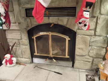

Do you know if it's an all masonry fireplace? With that metal chimney it sounds like a pre-fab fireplace. If that's the case you have a potentially unsafe setup. Can you post a picture of it?
A fireplace insert should have a masonry chimney with a stainless steel liner inside of it, not chimney pipe. Sounds more like a zero clearance fireplace. Could you post a picture?

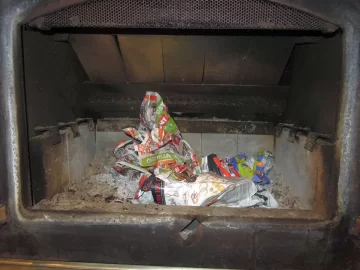

Here are a couple photos.

Correct, that is not an insert, it's a zero-clearance fireplace or ZC. I'm wondering if that is a Kozy 231ZC?

Thanks for the info on what it actually is. In the picture you can see I have the chimney damper wide open, and the air is slightly choked off (I loaded it up and went to bed shortly after). Normally the lower lever is straight up.

What happens if you shut the door? Does it smoke out, or just smolder?
the fire goes out. I guess I thought it wasn't drafting very well because until the fire establishes itself, it seems like the firebox is full of smoke and like it's not drafting well.
