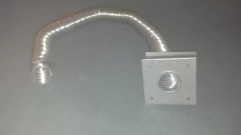

Did my OAK installation today.
[Hearth.com] Added OAK [Hearth.com] Added OAK [Hearth.com] Added OAK
Looks like the kit I bought. You may want to buy a aluminum tray in case it drips from condensation. I would get ice on mine when it was really cold. Although it would not drip it seemed to evaporate before a drip would let go.

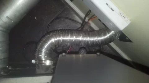

Mine dripped when I first installed it, so I wrapped mine in insulation and it solved the condensation problem.
What about the part that passes through the wall?
I just insulated from the stove to the wall. I don't think it was happening inside the wall since the air temp probably isn't as drastic of a difference.

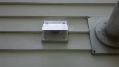

I also ditched the cover that came with it after the first season and modified a dryer vent to cover it instead. It seemed like excess moisture was being pulled in when their was big storms (sticky ash). The dryer vent covers a lot better without blocking any airflow and seemed to help the moisture problem.

Out of sight out of mind?? Mine condensed closer to the unit maybe the wall was colder?? Mine never dripped like I said but putting a $2.00 aluminum cooking tray under it gave me peace of mind.

Since the OAK pipe is cold air, I just kept the wall insulation right around it, so I'm assuming (hoping) that it wouldn't condensate in there like it did in the house.

I did apply a liberal amount of silicone on the outside to keep rain out. My stove is right next to the wall and, as you can see from my photo, there is only 12" (or less) of pipe from the wall to the stove.
