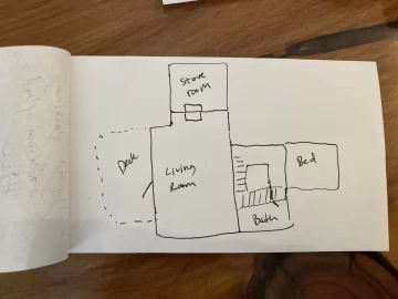

Here's a sketch... the living room (where the fireplace is) and the bedroom could use heat for sure, but getting heat to the bedroom seems impractical.
Not to scale... the living is about 2x the size of the stove room

To relieve overheating of the office room put a table fan set to low speed, on the living room floor and blow cooler air in from the Living Room.
