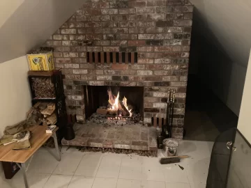

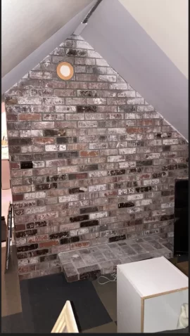

There is currently a 5" capped hole in my chimney (upper area, orange circle) and I want to add a small Cubic Grizzly Wood Stove. I'm hoping to learn as much as I can on best approach before I contact a sweeper / wood stove installer to get the job done.
Some questions I had:
- Should I chisel out the mortar, remove the cap, and stick my snake camera in there to see what's inside there?
- Cubic Mini company does not suggest and bends in the pipe, do you think I would be okay with 2 45 degree elbows?
The room is small (12x12) with low a-frame ceilings. The depth of the brick platform is only 17", and my friend has an unused cubic mini to sell, so I think that would be perfect. Every other wood stove I've looked at is too deep (24"+).
Thanks!!

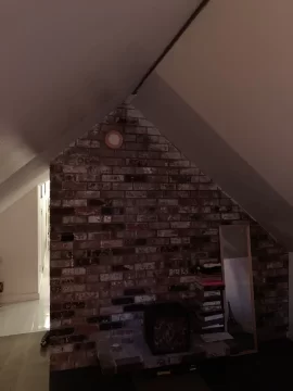

Some info on the chimney:

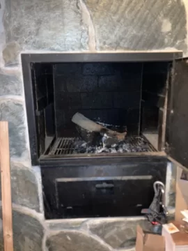

Downstairs has an open fireplace and outdoor smoker (opposite sides)
Upstairs has an open fireplace (other side of this photo), and the sealed cap for a free standing fireplace (pictured).
There are several things to check first, starting with your insurance company. The Cubic Grizly is not an EPA certified stove. Check with them to see if it is UL tested and permissible for US residential installation. If not, there may be better choices for the room and the hearth can be extended.
You will need to have a sweep drop a camera down the chimney to see if it is in ok condition and to make sure there are no other connections to this flue before proceeding. Only one stove is permitted per flue. The sweep should tell you the tile liner size too. The odds are an insulated 5" liner will need to be installed in the chimney to match the stove's flue requirement.

Well that's good info, thanks. The Cubic is out.
Sounds like I need to talk to insurance and get a sweeper out here to take a look.

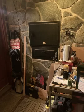

Here are some more pics. The landlord (I'm planning to buy this place because I love the chimney) put down tile on the fireplace side. Also pics of smoker downstairs which is outside (another guy lives there, we had a few beers and lit a fire in it). I don;t have access to the downstairs fireplace, but I know it's mostly stone like how the chimney on the roof end looks. The floor on the freestanding side looks like particle board with cheap carpet, so yes tile looks possible because the open fireplace side has it
[Hearth.com] Adding a small wood stove to a 1970s brick chimney that has a capped hole and platform for stove [Hearth.com] Adding a small wood stove to a 1970s brick chimney that has a capped hole and platform for stove [Hearth.com] Adding a small wood stove to a 1970s brick chimney that has a capped hole and platform for stove [Hearth.com] Adding a small wood stove to a 1970s brick chimney that has a capped hole and platform for stove [Hearth.com] Adding a small wood stove to a 1970s brick chimney that has a capped hole and platform for stove [Hearth.com] Adding a small wood stove to a 1970s brick chimney that has a capped hole and platform for stove

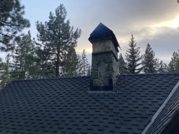

Attached are some pictures of the roof. The address is ****. The freestanding platform is on the left side of the roof pictures.

Climb up on the roof, look down the chimney.

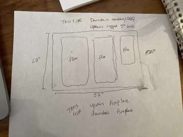

I’m going to bet you only have two flues in that chimney. One for the fireplace and one for the smoker. Which means you can’t use a wood stove there. If you have three, I’ll be surprised but it could happen...
Reactions: SpaceBus
Even if you have 3 flues it could be 1 for each fireplace and 1 for the smoker, hopefully the best bet would be if the upstairs fireplace has its own flue install an insert. use a small blower on the floor in the room behind the fireplace to blow the cold air towards the room with the insert. that would be the most practical thing to do if you had a stove on the backside and burnt the fireplace at the same time most of your heat would be sucked up the chimney flue.
I climbed up there and snapped a photo! It looks like I have 3 flues, 2 equal size and one smaller one (raised up, in rear of photo). So I have 3 existing working appliances, plus that capped hole for the wood stove I want to add. How would this work? Do the fireplaces share a flue or something?

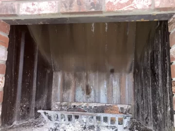

The upstairs fireplace does have a steel insert, pics attached.

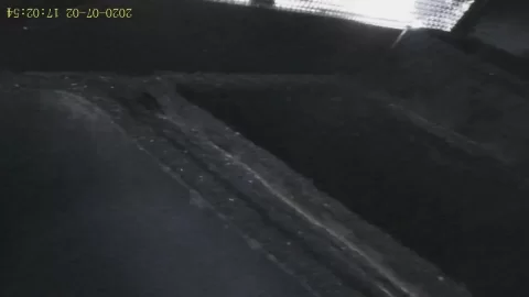

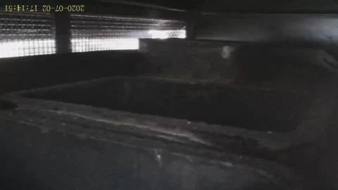

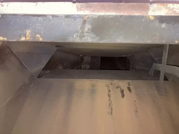

Here's a video of my snake camera for more details:
Couldn't take off the rain cap by myself.
[Hearth.com] Adding a small wood stove to a 1970s brick chimney that has a capped hole and platform for stove[Hearth.com] Adding a small wood stove to a 1970s brick chimney that has a capped hole and platform for stove
OK, the sweep was at a disadvantage. It sounds like without being paid to inspect on-site, he was just giving his opinion. This is new information. The flue might work for a small stove if it is in good condition. A little Morso would be nice.
