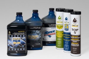

This is the stuff i switched to...
Thanks for the link. I found an online retailer and ordered five tubes of the Top5. I love that it's safe for the environment since I'm fairly certain all the grease that goes into my tractor is going to end up in the ground water some how.
Reactions: Don2222
Thats one of the reasons im using it as well... I do alot of creek crossings that are fish bearing so the less of a foot print i leave their the better...
