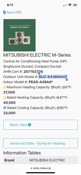

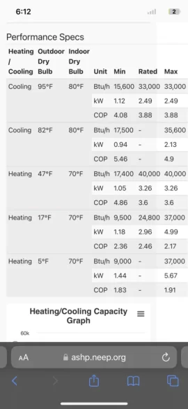

I’m still not sold on viable speed for whole house applications based on a pure value perspective. The one I linked I found a very similar model number SUZ-KA36NAHZ full capacity at 5dF.
I believe that PEAD-A36AA air handler is the concealed duct type, not an air handler meant for an existing duct system. But yes, Mitsu has units that can definitely heat down to my design temp and below, but they're quite expensive.
My main reservation about variable speed for a whole-house application is my poorly-balanced duct system; I'm going to see if I can remediate that before making a decision. Since I heat almost entirely with wood (like most of us here), I don't really need to get this new system running until next May or so.
And since you heat with wood ROI on any extra money spent on efficiency takes twice as long. Get. I’m guessing your heating demand is probably higher because than cooling, so even longer. Get a panel that will power 8kw or 10kw strips and now you don’t have to really worry about heat output at 17 F or lower. Lots of options become available.

That being said, I'm willing to pay more, but not more than double, for one of the marquee Japanese brands. I tend to hear that Fujitsu is pretty much equal to Mitsubishi in quality. And this $5643 Fujitsu has specs comparable to the $8652 Mitsubishi:
I don't believe either needs supplemental heat. But it may not be a fallback position - since it's not clear if either of these has provision for heat strips in the air handler; generally these vendors will list it as an optional accessory, if so.
