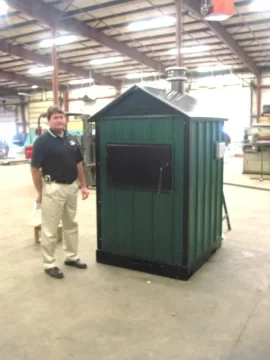

Here are pics of Phil and a Rusted 3 month old boiler

Thanks , everyone gets to see Phil but no one can talk to him . Is that an indoor unit ? It looks very similar to mine .
That pic of Phil would go good on a dart board
Hopefully his picture will get his attention and if he contacts me I will let you people know. And if there are any questions please fire away...
I see Phil has a phone too bad it doesn't work. I hope something happens with these boilers. I'm pretty sick of mine. The MN attorney general has gotten no replies from him at all. I wish Maine would step up and do something they at least could find him, maybe. Keep everybody posted. Thanks Jim
