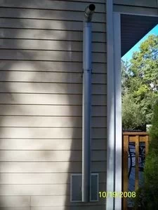

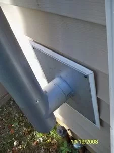

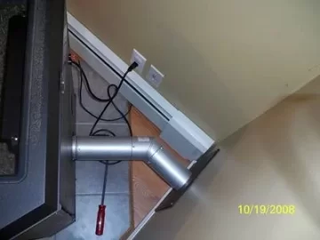

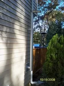

Second season using my Advance2 and two months into it I am getting smoke in the hopper. No issues last year and same pennington Natures Heat pellets. When it's 3/4 to full of pellets it is hard to see but when the lid id open it smells like smoke. 1/2 full to next to empty it is so bad that smoke detectors go off when the lid is open for more than 30 seconds. Dealer had me clean it again and try different pellets, did it with same results. flue goes 2 feet then outside building to a tee then 6 feet up with a jet cap, all cleaned to a mirror right to the stoves' comb. blower. Hopper is sealed at all fold joints and I siliconed where it sits on the feed box. I notice the slide plate has cresote on the front edge where it never did before.

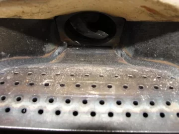

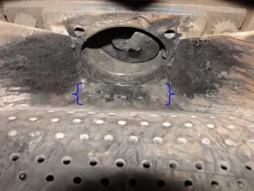

I also understand that the burn pot with the 5 holes (which I have) near the base is a cause of the auger tube to crack. Fire in the tube and on the auger tip overheats the tube. This is also a cause of heavy clinkers at the base of the burn pot by the auger tube and on the auger tip. I wonder if this "kit" includes the new burn pot without the 5 holes.
These are not my pics but show the different burn pots

the kit does not come with the new burn pot but the directions with the kit say to discard burnpot if it is one with 5 holes in the bottom and replace it. these hard parts of the stove have a 6 year wearranty so remember that.

Maybe it's the pics but the new burn pot looks different than the old one.... the way it angles down to the auger is more of a straight ramp.
It's the pics. The pot are the same but for the 5 holes at the bottom. Seems like Hamon saw the error or "defect" in design of the Advance and now not only have a Advance2 but also a new model advance with new manual, hopper switch, direct drive auger, feeder weldment,feeder air intake to name a few and did away with the hopper muffler which I could not find on mine.
