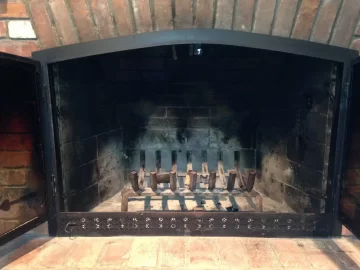

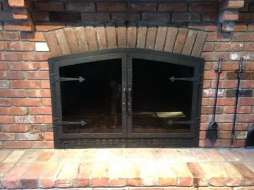

[Hearth.com] Advice for a WBF Insert [Hearth.com] Advice for a WBF Insert
That's a beauty of a fireplace. What is wrong with the doors?
How long would you be burning at one time? A few hours or all day on weekends? How is this room connected to the rest of the house? How high are the ceilings?
The doors are failing. They're loose. We would normally burn wood on a special evening and holidays. A few hours a day. The room is a one story extension off the back of the house. 25 X 15. seven foot ceilings.
