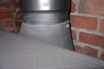

I have never heard of using stove cement around a connection like you suggest, I think using stove cement would indicate a problem with a connection, not to mention a real bear when disassembling to clean.
Well how do you seal the joint?
Rutland Furnace Cement - "Seals metal to metal. Ideal for bonding joints less than 1/8". Seals flues. Seals joints smoke and gas tight."
I'm just reading it off of the container. It took about 1 minute to do this and I know the pipe is perfectly sealed. Cheap insurance. You could also use a gasket rope as Jotul recommends. I had virtually no gap and no rope would fit in there.

I have no rope and no cement and no gap on my connection. If the chimney draws as it should, smoke should be pulled up the chimney, not spilling out. The only problem would be in the event of a flue fire it could pull air in to fuel the fire, just as it would at every connector pipe joint.
I'm just tellin ya how Jotul says to install their stove. From page 18 of the GB manual,
Note! It is important that the joints are completely sealed. Air leakage etc. may lead to malfunction.
I don't know how you completely seal a metal-metal joint w/o a gasket or sealant.
The biggest thing is that those bolt holes should be drilled out and the screws installed for safety. Otherwise you are relying on friction of a tapered joint to hold the stove pipe end in place. That doesn't work too well. As you point out, if the stove is opertating properly, this shouldn't be a problem. However, you want to have that pipe secured so that if you have a bad event occur you know it is not coming out of the stove. This is the same reason why 3 stove pipe screws are required at every joint.

Interesting about sealing the pipe to the collar. I've just got mine set in there firmly and I tightened the bolts a bit. I was careful about not overtightening them and bending the pipe.
You know, I did that at first too. Then my engineering brain kicked in and I said, something does not seem right. Then I read the GB installation instructions. Jotul has a lot of good info that they put in the Euro manual which for some bizarre reason did not make it into the USA version.
I am not a pro stove installer and I am not trying to tell people what to do. It's your house and your stove, do what you want. The installer at my shop said he never seals the flue pipe to the stove. He just shoves the stove pipe in as far as it will go and lets the draft take care of things. The owner of the shop smiled when he heard this conversation, handed me a container of furnace cement, and said, use this if you want to do it the right way. What does it all mean? Umm, if you have a good draft, a perfect seal is prob not required. If you want to do it the right way, seal the pipe and drill the holes.
That's some interesting advice. Maybe I'll give this a shot....
I'd like to hear from more regulars about this flue cement thing- BG< Jake, specific to the Oslo. Mine is not cemented.
IIRC, for our install (not using a liner) the DVL pipe just bolted right on to the stove collar. I don't remember cementing it.
Mine is not cemented and I don't feel this is necessarily the "right way" to do it for everybody. I have a nice tight fit, but can still disconnect my pipe and tape a bag around it when I sweep the pipe clean from the roof. How do you guys clean your pipe if its cemented to the stove?

No furnace cement in mine either. I am using double wall pipe though and boy what a pain in the arse for me to get a nice fit on that flue collar. Don't ask me how your supposed to cement the flue pipe with the double wall hanging over the outside of the flue collar.
No cement used here either . . . good tight fit for me. That said, come Spring I may at the very least drill out the hole for the bolts . . . to me that kind of makes sense . . . even though I have had no issues with it so far (of course I also have gravity working with me as there is a 3 foot length of double wall pipe coming straight up from the stove/pipe collar.
No cement on mine either. I'm not worried about drilling the pipe for the bolts because I have to slide the stove over a few inches just to be able to remove the pipe for cleaning.
