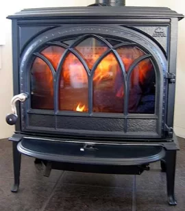

The ivory or the blue-black enamel process is a tougher finish than the majolica. It looks very sharp and stays looking good. The stove cleans up at the end of the season with a quick wipe of a damp rag and looks like new. We had blue-black on our Castine and loved it. The painted finish looks dusty after a few years, no matter how well you take care of them.
PS: this is the way our F400 looked new. It looked just as good when it was sold 2 years later.
  • [Hearth.com] Advice Jotul 500 Oslo in Alabama
