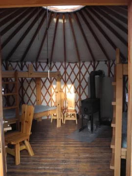

Now that we have our stove picked out, we are discussing hearth pads. Initially, we had just thought about putting down 1/8th inch steel. We are modeling our yurts after some yurts at the Porcupine Mountains in Michigan and they put down some thin tin or something below their stoves, although they built their stoves and they sit pretty high off the ground. But then we started reading the install manual and got nervous about the r-factor and if we should do something a little better. This is the Porcupine Mountain Yurt:

Wood floor means that R value of hearth pad requirements need to be followed. If I remember correctly (no guarantee). The 13 requires R2 for the hearth pad. R 1.5 won't cut it.
No reason that this can't be a DIY project. Just make sure you use the proper stuff to obtain the final R value required in the manual.
The 13NC has high hearth insulation requirements. There are certain fiberboards that have a high insulation value, but you may need to go up to 1" to get or exceed the R=2.0 requirement. A fairly thick sheet of steel on top of the fiberboard will be needed because the material is quite soft. I would go 20 ga or thicker.
1" Micore 300 = R 2.06
1" Fiberfrax Duraboard LD = R 2.2
The other important issue that will need to be addressed with the 13NC is chimney height. The stove is going to want 15ft of vertical chimney. If the stove is vented through the side of the yurt it may need more due to the 2 turns coming off the stove and up the chimney.
