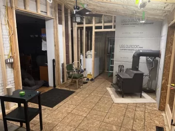

So I bought a 1903 farmhouse 7yrs ago and gutted it completely, all new windows and insulation. Just finishing up the last phase of the addition where our current Kodiak wood stove is located (2 story 1600sq ft plus 300sq ft addition. The old stove does a good job heating the entire house but we wanted glass doors for a nice new of the fire as we sit by it a lot. So after doing some searching our eyes were opened to a whole new world of wood stoves!!! We struggle to keep our current stove burning when we are gone all day & overnight. We burn it from Oct till April as our main source of heat (with oil back-up). I'm open to any brand been looking at the BK Ashford 30, Hearthstone Manchester, VC Defiant and Iron Strike 300. Please help me decide CAT or Non-CAT brand and size!!!

The stove is in the 300 sq ft addition correct? And had that single doorway to the rest of the house? How does the current stove move heat? My only concern is that the non cats burn cycles may make that room much hotter than you like but you’re likely used to it with that big old beast.

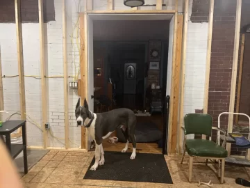

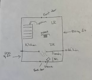

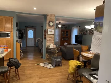

I'd like to understand how heat circulates in the house, especially if this will change once construction is completed. Is the 3' doorway (with the GD) from the stove room the only way heat enters the rest of the house? Can you post a floorplan sketch?

20' brick terra-cotta pipe lined chimmny and was figuring in the 4k range... willing go higher but only want to do this once! I have a 6' doorway (300sq ft addition) that I use a fan to push the heat, but its defiantly holding more heat in the addition with it now being insulated and the spray foam ceiling.

Doorway is in the middle of the house its 6' wide 8' tall with 9' ceilings throughout the 1st floor. The first floor is a completely open floor plan with the open stairs to the second floor on the opposite side of the house. The upstairs stays colder but its perfect for sleeping and the bathroom floor has in floor heat. The oil is set at 60 and never comes on... at night it will drop down to 64ish but a raking of the hot coals add wood and its back up in the 70's in 20 minutes. Same after work house is chilly till I fire it back up. I'd like a more constant heat for over night/away at work. I'll try and draw a floor plan sketch.

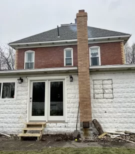

Most would advise against venting a BK into an exterior clay lined chimney. Advice would be to line with 6 inch stainless and insulation would be recommended and possibly required if the chimney doesn’t have the required clearance. Adds 4-500$ to install cost.
Same advice would be given for a non cat but your results might be better given the higher exhaust temps on a non cat stove.
This all depends on the current size of the clay flue. 8x8 is nearly impossible to get an insulated 6” liner down without breaking out the clay.

Is the plan to move the stove into the main open area and vent via the chimney at the barrel's location? Or is the chimney currently servicing the oil burner?

The old Kodiak is not as fussy with fuel or draft. Modern stoves need 2 things, fully seasoned wood and decent draft strength. The chimney setup has some caveats for a modern stove - exterior exposure, no insulation, and it's on a one-story building addition. A cat stove runs lower flue temps and thus is fussier about these requirements.

Called a local chimney sweep Company and was told it would be around 9k to remove the terra-cotta liner and put in a stainless insulated liner!!! Rethinking this whole idea now…

What are the inside dimensions of the current clay liner? My apology if you have already stated this.
