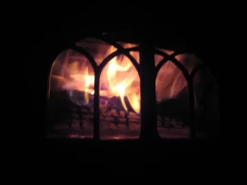

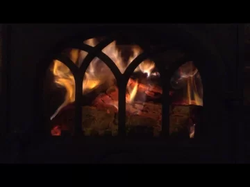

Here is what some good dry oak looks like when it's burning. I took these photos last night after my last reload of the night.
[Hearth.com] Advice on burning Oak?
These photos were taken about 15 minutes after a reload on hot coals. The stove was running 400 F with the reading taken on one of the corners on the top as instructed in the owner's manual. When I shoot the center of the top with the IR thermometer it goes over the 600 F limit of my thermometer. Whenever a member cites stove temperatures it's critical they take readings from where the manufacturer specifies. My stove reads 50% hotter on the top center, but if I said I had the stove burning at 600 F then my stove would actually be over 900F on the top center, which is probably getting up to glowing stage.

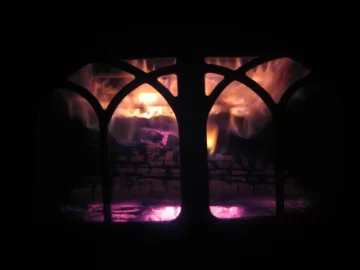

That's so funny Nick M... Look what I'm staring at right now. Think this obsessive's got the hang of the oak now!
