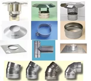

Need suggestions for different chimney top cap. Am using a raincap with screen/wind shield that came with the Olympia Chimney Armor Flex ss liner kit I installed 5 years ago for my PE Summit insert. The cap tends to collect too much creosote because of the screen and shield. Also the cap installs inside of the 6" liner requiring sealing with hi temp silicone each time I remove and clean. Are there caps that fit over (outside) the liner? Will I have to deal with bird issues if I go with an open design cap? A picture is attached. The cap I am using is on the top left of picture. Need specific ideas. Thanks.

Why are you dealing it with silicone that is completely unessecary. The ones that slide in are much better honestly I would just cut the wind band off of the one you have and use that
Bholler; I used silicone to prevent water entering inside of liner. Probably not much would enter as it does fit pretty tight. Thanks for your idea of modifying the cap I have. You always give good advice! Thanks again for you time and thoughts.

Remove the screen and then fasten a wire screen to the cap in the off season to keep birds out.
A chunk of mesh, two pieces of wire, and 30 seconds is all youneed. .

The Sooteater I got comes with an extra string that mounts to the top of the cone that is supposed to clean the chimney cap. Perhaps try this setup first before you modify the chimney cap. The latter will require you to make 2 ladder climbs to the cap ever year.
