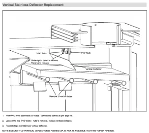

It's a simple thing to check. See page 23 of the manual or have the dealer come out and adjust the vertical deflector.

To remove the baffles, the smoke deflector needs to be removed first. Then the front two tubes get removes. After that the baffles should come out. Do this carefully, they are somewhat fragile. Page 15 shows how to install. Do the reverse.

Thanks for the reference pictures, I know about it and have follow the instructions but my problem is with the firebricks, I just can't lift enough the first one for removal to access the baffle above. Perhaps since the bricks are new and not "worn" a bit they may need a tap with a hammer but I'm afraid I may damage the brick. In any case assuming I can access the baffle above I still have to work on it and it may be difficult so it's much easier to try first with a new cap.

Could the vertical deflector be too low and preventing raising the bricks?
It is possible the deflector may cause the problem...., the attached picture shows the old Regency but also shows the step in the front. This step prevents me to do the required work because I find it difficult due to my age to bent as needed and have a proper look. Now Spring is here so I may find someone to have a look.
