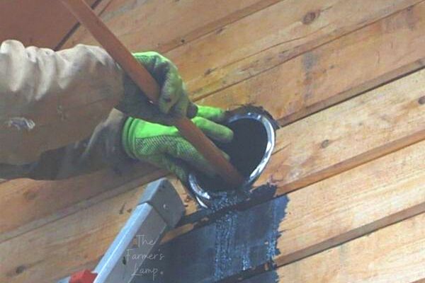

I found this on the net and would this article be good advice for the flue cleaners attempts at cleaning out the wood stove at your sisters house...You most likely already know about these things but it was interesting to read anyway..
That's a nice homey article, but it says little about the actual cleaning. Looking at the pictures, it's no wonder they are getting such a huge amount of creosote buildup. Worse than that is their illegal, stovepipe chimney (it must be insulated class A) and the fact that the stovepipe is installed upside down. This is why they have creosote dripping down it.

They mean well, but there are some really bad articles on stoves, wood burning etc. out there. It keeps us busy here. Meanwhile, this is not the definitive article, but more helpful.
