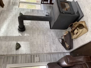

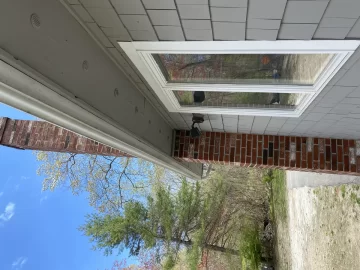

Hello! Brand new here. I'm hoping someone can help me out. I currently have a wood stove in my family room. It was previously a pellet stove so there is a brick chimney which the pipe vents into. I love the heat and the warmth, but I don't love the big ugly black pipe and the ugly white brick hearth that it sits on. I have dreams of a beautiful stone hearth with fireplace insert. I did a bit of research last year when I started thinking about it, and I was told that my best route to take would be the Northstar made by Heat N Glo. My first question is - should we frame out on top of the existing hearth and then install the Northstar? Or should we rip out the existing bricks/hearth and install the Northstar into the wall? I attached photos of what we have and what I want.

This would require a total replacement of both the wood stove and chimney, then construction of a chase and new chimney system for a Zero Clearance fireplace. Can be done, but it will be quite expensive.
The hearth would be removed too. How large of an area is the stove room and how open is this to the rest of the house?

A much less expensive option would be to paint the stove and stovepipe white.

Now I am brand new at this stuff but that stove chimney does not look that big --thin looking and tall--is that an okay one for the size of that large stove? If you have the money I say tear out the whole thing and get exactly what you want--Yes ...If it were me I would get a free standing stove and make the background beautiful like you want and I would be looking at those bari"s,,I love those,,clancey
