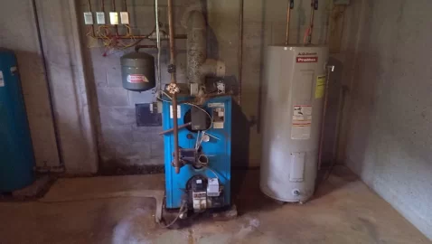

Mike I took a picture of the unit. I have two cleanouts but dont know if its 2 seperate flues. How do I check?
Two clean outs means you should have two flues. But I don't see another thimble in the pics. Do you have a woodstove hookup on the main floor?
the second picture has the two black boxes which are the cleanouts. I have a fireplace on the first floor.
That does limit your options a little. You could have the oil burner put on a direct vent, install a class a chimney. Or like you said look for a combo unit.
Possibly you could have a mason brick up the fire place and set up the second flue to be used in the basement. Depending how the chimney was made it might not be an expensive project.
