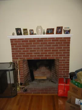

Well...the fireplace dimesnsions are a little tricky since it tapers down toward the back pretty quickly so width becomes an issue with increasing depth. But it's 30 inches tall and 27 inches wide at the back and 41 inches wide at the front with a total depth of 21 inches. The brick extends 20 inches out to the hardwood floor.

Going to try to upload a pic of the fireplace (fingers crossed)
  • [Hearth.com] Advice on New Insert
You're right, the taper is an issue. A freestander will go in there. Take a look at BrotherBart's avatar. You can get that stove for under $1K and it is a serious heater. For your house the next size down, the 13NC would also work with a bit more feeding. That can be found for around $700. The hearth will need extending, but either should fit.

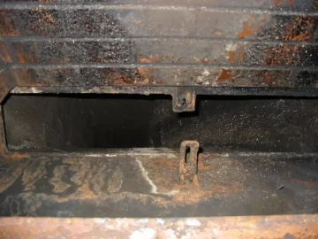

What is the throat width at the damper location?
LandscaperDarryl said:
So how do I remove this damper....as you can see I've gotten as far as getting the door off.
I widened the center of my damper with a hand grinder. I cut all the way through on the left and right sides and scored a line about half way through from left to right. Then take a hammer or vice grips and the cast will break along the line. I also smoothed out the break so that it doesn't cut into the liner. (Use safety glasses)
Harbor Freight sells a crappy little $10 grinder that's suitable for the job. If you spend $20 or so you can get one that's less crappy but should last a number of years.
Note: After you do that, you will not be able to use it as a conventional fireplace again. Then again, who would want to ;-)
The throat is just a shade under 6 inches so I think I'd have to go to an oval liner pipe to get through it without enlarging it. I'm really not too keen about hacking it to make it larger. I do have an angle grinder and cut-off wheels though. I'd much prefer removing it entirely if it can be done without too much trouble.
