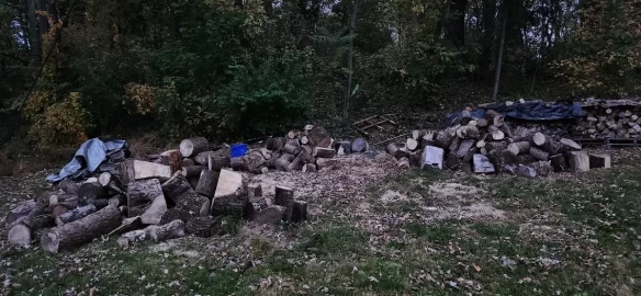

I just had a 90 or so year old hackberry taken down. It's about 2.5 ft in diameter and very difficult to split. Also lots of limbs. Does Hackberry get any easier to split as it dries? I have been splitting the rounds with a chainsaw. I have been thinking a splitter for the rest, and I have never used one before. It's hard splitting.... Even with wedges and sledge. There's some walnut there too. No problems with that.

I'll have to try the canola oil. I like the idea. I have tried noodling some, it binds up my bar sprocket all the time but it doable. The wedges stick into the rounds better now that's its drier. so its a bit easier but it's still all sledge and wedge. The plan is cut it all to length, quarter it with sledge and wedge to pick it up and then rent or buy a hydraulic splitter for the rest. I have been cutting and quartering it. Definitely not easy.
Another update. I let it sit out all summer, it splits much better now after its dried. The huge Vs don't split at all though, will probably throw a good potion of them in the woods. It's easier to get a different tree... I tried to buy a splitter, but the cylinder was rusted internally and leaked and could not be rebuilt. A new cylinder was more than the unit was worth. $400 down the drain on the splitter and a lot of work trying to fix it. (Getting the engine running abd new tires) I scrapped it. Very frustrating.
