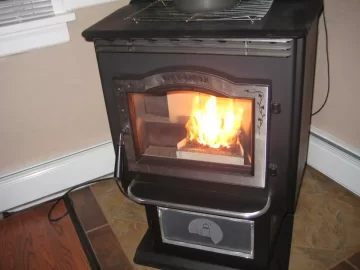

Btw: my wife wanted to buy a stove based on looks. Could have been the xxv.
Sorry. Posted too soon. Anyways , since i would be the one maintaining it, we chose the p61 for the ease of cleaning. We did spring for the shiney metal decorative ad ons so it did not look plain jane black.

9 inches at the corners but we have heat shields on both sides of the stove since we are in a corner.

Forgot to mention that I have a 1920s old house that is not well insulated at all and the p61a is keeping the house very warm with hardly any effort.
