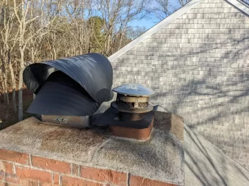

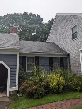

Our short chimney :(
[Hearth.com] Advice request for wood insert
On left is to fireplace, was hoping this wind resistant cap was going to resolve the downdraft but it had little effect
That helps a lot. The issue could be a combination of a short chimney and the location next to the taller roof of the house. "Hearths installed in single-story sections of two-story houses almost always perform badly." An insert may also have an issue here unless the chimney is extended.
