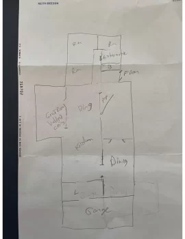

Looking for your expert opinions and experience in selecting the right insert for North East home. It appears the decision comes down to cost, looks, and proper size. We want to augment our oil heating (w central air) by converting our useless fireplace to heat the home. I have plenty of wood on my land and some dried for 9 months.
The fireplace room is on one side ofthe house, see image. this level is 2230sqft with a vaulted ceiling in one room. Basement will only be heated with oil. One concern is if the small room will get overheated and rest of house won't be heated? Thermostat for Kitchen/Dining/Dining is in the "Dining" room next to the FP.
IMG_4281 (1).jpg IMG_4283 2 (1).jpg Screen Shot 2023-01-14 at 6.13.16 PM.png
Note: I'm aware not supposed to burn on that, it's for holding wood! FP was never used!
Measures indicate can fit a large insert: Height: 28.25, Width: 35" D: 22.5 . If the unit is not flat, will have to put something on the wood floor like a fireplace rug or metal.

The Lopi Evergreen is a good choice from those listed. What is the width of the fireplace at the rear?

24 inches in back. Good to hear, other than having to have protection on the floor I favor that one for cost. Any particular reasons why you like?
