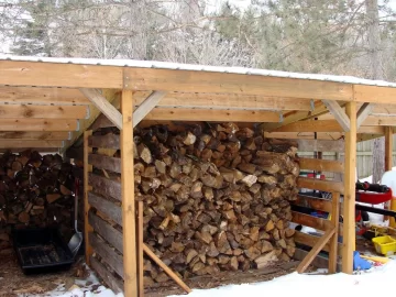

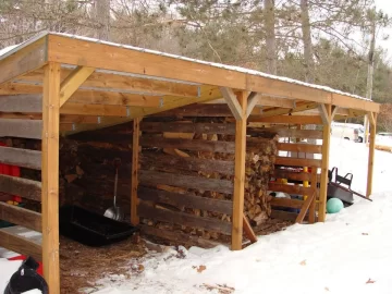

Here is how I did it, I finally got sick and tired of using tarps for the past 20 years and always having wet wood that would never dry as the result. Ignore the two right angle pieces in the front with the 45 degree braces- those are nothing to do with the wood shed- was just storing those there for the time being.
Anyway, you could build yours the same way either free standing next your house or attach it using a ledger board as you suggest, except you would have to pitch it the opposite way (toward opening) so to shed water away from the house foundation. There are advantages and disadvantages to attaching to the house- either way is ok to do depending on your local codes. Mine is 16' deep by 24' long, having 3 bays each as seen in photo. About 7' tall in front and slopes to about 4.5-5' in back. Snow sticks to roof at this slope, but built strong enough to handle it. The way I run it I have one bay drying, one bay already dry, and one bay to store splitter and kids outside toys, etc. I burn wood 24/7 all winter and I use only a bit over one bay, using Lopi Liberty. You should be able to see the detail on how I built it- used 4x4 or similar round posts going into the ground down below frost (doesn't matter here anyway cause all sand soil, no frost action). Lagged everything together or used deck screws. Frame is 2x8, rafters are 2x6. Corrugated steel roofing. side slats were just some old oak fencing boards I had laying around or 2x6 material. Was pretty easy to build myself and doesn't look too bad. Didn't have a pre-made plan, just figured it out as I went. Should have gotten a bit longer metal roof lengths but otherwise wouldn't change anything. May not be fancy enough to attach to a house but you could dress it up however you like.

As far as the rafter spacing goes, the corrugated plastic panels are designed to run perpendicular to their supports so I think technically they are run over "purlins" like pictured in Wi_wood shed. Rafters 24" OC would be fine if you have at least 1x2's running crosswise over top or just run purlins between the rafters that go to each post as Wi_wood. Nice shed by the way!
