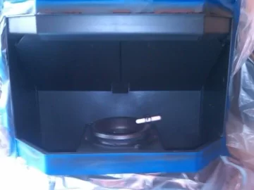

Here is what the inside of mine looks like over the Summer :)
[Hearth.com] Advice when looking at a used MAXX
For me it would depend on asking price. I wouldn't pay top dollar for that rust bucket.
