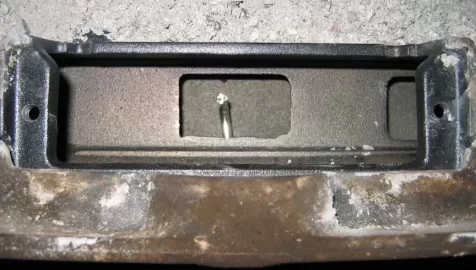

I just took my air control apart. There is the upper vent "sled" (part 104082 on the F400) that slides in the cast "track" beneath it. It would have a hard time binding as there is about 3/32" play all along. So for those whose vent sled is binding can you check to see if there is equal side play at both open and closed positions? If yes, is the "sled" trying to twist sideways and binding that way?

Thanks for the photo offer but I had the dealer show me the one on the showroom and it looks the same as mine, including the imperfection on the valve itself. The one on the showroom moved slick as silk though.

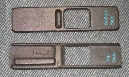

Missed your post snowfreak. Here is the F400 vent slide shot. Maybe it will help koavt. The width of the F400 vent slide is 1 19/32", length 6 11/16".

Yes, I see now that it's similar, but the F400's is smaller, covering 2 air holes instead of 3. Maybe the additional length is forcing the vent plate to try to track at an angle which is causing it to bind? Just a guess, but perhaps the track may have too much slop allowing the vent plate to twist in the track? With the vent cover off, try placing a flat piece of metal alongside of the vent plate, on the interior edge of the track, so that it narrows the track width by about 1/16 of an inch. A 6" flat metal ruler or a thickness of plastic would do. Then try the air vent valve action to see if it's smoother.
