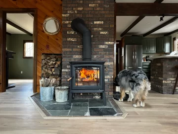

Morning, Gang -
New stove and liner installed this past Wednesday, so popping back in here to update. After working with a couple local stove shops and installers, many questions, and a lot of time spent digging around the internet, I landed on:
  • Hearthstone Shelburne
  • Double wall stove pipe
  • 5.5" stainless liner, 21' (flue tiles were cracked and slightly offset, so had to downsize)
Came down to this one and the Lopi Evergreen. We ultimately ended up with the Shelburne because of 1) dealer and installer experience, and 2) aesthetics (it's the centerpiece of the house). All else felt pretty equal with the two stoves with only minor differences. Hearthstone's mothership is also only an hour away, so that felt better. Installer (shout out to Alpine Stove) was able to give me plenty of loading side clearance by working the stove pipe to get the stove right up against the chimney, so that's a relief.
Did a handful of small, a little bigger, a little bigger, etc. break-in fires since then and this morning is the first "real" fire. 23 F outside when I started at 6 AM, got the stove up to 575 and it's been cruising ever since. Drafts great, no smoke issues; this is what I saw the most chatter about on this forum so I'm glad it's working as intended. Most of my wood is what I have found to be "good enough" at 18% - 19%, which, having just moved in this fall, is a relief. Might have to be selective on some of the stuff I put through this winter, but looking forward to burning the stuff with multiple seasons next winter.
One thing I noticed during the break-ins was that the glass got dirty pretty much every time--could this be a wood issue, or just because I was burning at low temps with restricted air flow? My assumption based on my split MC tests is that some of them were a tick over the 20% threshold, but since I'm new to this I will continue to question everything.
Anyway, I feel like this forum could use more positive notes on this stove, so I'll update periodically. So far, so good, but I will come back if I have questions. Thanks to everyone who responded to the original questions in this thread, it was all super helpful!

Looks super! Try loading N/S to see if glass stays cleaner...
BKVP
Reactions: N_Weeks
Possible issues, internal firebox temp too low, you need more air to obtain higher internal temps. Wood moisture is too high ( re-split existing splits and verify the moisture content in the middle of the freshly exposed opened face ). If possible to load front to back (north-south) try that. Use smaller splits to obtain higher internal temps initially, 2'' to 3'', you may need to re-split some of your existing wood, once you been burning hotter for a couple of hours and the glass clears up you can ad larger splits.
Usually a smoked/dirty glass clears up when the internal fire temp is sufficiently high and for a good while, the heat/fire burns the soot, carbon and crap off. Dirty glass confirms burning too low, wood not quite ready to burn, poor draft or a combination of.
Reactions: N_Weeks
