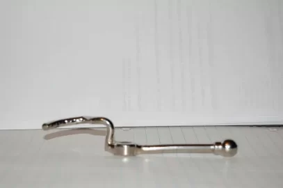

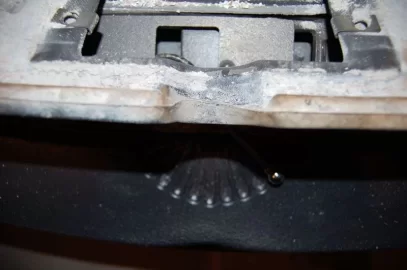

I have experienced the same problem as bj20's. I have the new control lever and I've tried to adjust mine from med to high on the bolt with no success. I have also noticed that the notches (Seashell pattern on the bottom of adjust lever) are not the same as the old lever. If I place the new lever in the same setting as the old one it allows more air in. Not a huge problem but it takes some getting used to if you had the old style lever. For the past two years I now use a small wooden hammer to adjust the lever. I don't force it I just give it gentle taps. I burn 24/7 and have always had this problem. I tried wd-40, high temp grease, polishing the sides of the cast iron slide, replacing the cast iron slide, replacing the control lever 3 times including the new and improved one, making sure no burs are present anywhere in the slide path, making sure no cement was present on bolt or slide channel, replacing the stove. Its come down to a toy hammer from one of my son's play sets. Bj honest to goodness if you can't find a fix try a small wooden hammer. Its light enough not to bend the lever and the wood has not damaged my enamel paint yet and I doubt it will. Try not to laugh its the best fix to date. Here's a picture of the new and improved lever does your look like this too?
that is not the right lever for the 600 from the looks of the pick

bj20, can you post a picture of the control arm on your stove and maybe one of the assembly in place with the doghouse cover off?

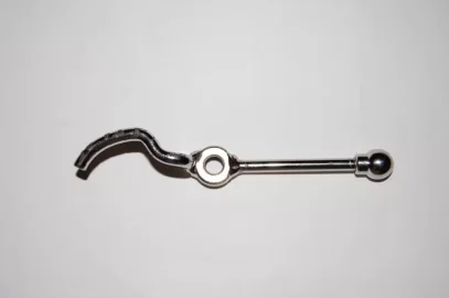

Maybe the picture is not doing the new control lever justice. The old one had a distinct 45 degree bend in it. This new one is much more rounded. From what I understand the old one would get caught on that sharp bend. Before I was able to get a factory distributed chrome plated lever the place where I bought the stove was sent a template to make the old ones look like the new design. This new one matches what my old one looked like after they used the template. It has a much different look than the original. Side by side you could really see the difference.

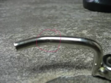

BJ unless they have released another new lever in the last two months this is the right one. Where the red circle is where the sharp bend used to be on the old style. If you have a sharp bend there its the old style. Mine fully closes at 1 1/2 notches and full open is 8 1/2 notches (seashell marks) it starts to move the slide immediately. There is no play before it starts to open
or close. It sounds like the installer does not have your adjustment lever between the two
uprights on the sliding damper, or its the wrong part in there. This part I took a picture of is an extra that I have, the one currently in my 600 looks identical to it. Hope this helps you.
  • [Hearth.com] Air damper issue on Jotul Firelight 600 still unresolved after warranty replacement of air damper ar

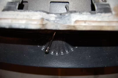

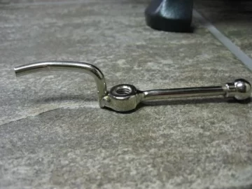

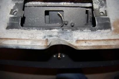

I contacted my dealer "A Cozy Fireplace":( and told him that my stove wasn't getting full air, wasn't closing all the way, there was a bunch of slop/ play in the lever, had a reduced range of motion and was still sticking. Their response... He suposedly talked to the tech at Jotul who actually designed the new lever. He claims the new lever is supposed to have a reduced range of motion to prevent it from sticking. He claimed the reason I had reduced air was because of a creosote buildup. He assured me his installer had installed the new lever correctly. Yeah right! Creosote buildup overnight that coincides with his guy putting in the new part. Now what he should have said is, Hey let me send someone out there to check it again as something must be wrong.
So I called and talked to Jotul Tech support myself and here are the facts.
The Oslo and the 600 have the same air lever. the difference is that the Oslo comes with an additional part(s) for the air kit. The lever does not work in the Oslo without also changing the air kit but the lever itself is the same.
A few years ago something changed in the manufacture of the 600 that has never been Identified which causes the sticking problem. They have created the work around with this new designed lever. The new lever will work as long as you get one from a batch that is in spec. The problem is that from time to time a batch comes in that does not meet spec and therefore does not work properly. Jotul is sending me the correct lever even though I think I did get the correct one.

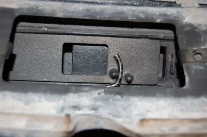

The tech told me to remove the air cover and check that the lever is between the 2 nubs. It wasn't as you can see. Full open was actually less than half open. The reason for the slop was because it wasn't between the nubs. I took it apart and installed the lever correctly and now it works just fine. very little play, full range of motion etc. I posted pics to show how it was and the new part.
Notice when I had the stove full open the slide was less than half way open. Pic 2 What they called a correct install. Pic 3 full open & Pic 4 full close. Plus pics of the new part.

Follow up with a Pic of the lever installed correctly. I will verify that the parts are the same when UPS delivers my additional new lever from Jotul.
Unbelievable! Thanks for posting the pictures bj20. You don't need a college degree to see how it was intended to be installed an work. It looks like if one has the correct lever, it's a simple thing to check for proper positioning. Sorry you had to go through such a run around, but it's good to hear that the stove is now working as designed.

the service tech must not have taken the dog house off when they put the new lever on it can be done that way but not the best way to do it. to make it clear the oslo uses the same lever but it needs a diffrent air slide plate other wise the f 600 lever will not work.

I received my extra lever from Jotul and it is the same as the one the pictured above. This is different from the one pictured in snow freaks post.
