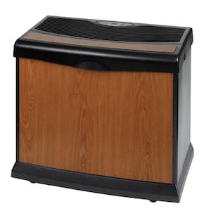

Definitely sounds like a humidity issue to me. Pots/pans of water on the stove will do little to help unless you have a very small area to cover. Get a plug-in humidifier with lots of water storage capacity. Mine has two tanks that I fill just about daily.
Link to the same unit I have.

I definitely need a humidifier. I woke up with a bloody nose the first day after running the stove. That's definitely due to the lack of humidity. I bought a cast iron tea kettle and put it on the stove the next day in the hopes that it would help. The next morning I didn't have the bloody nose, so it helped a little. Part of my plan is to put a SS stock pot on the hearth next to the stove both as a humidifier and as a heat sink. I have a Lodge cast iron dutch oven I could use for the same purpose. My stove is steel, so it doesn't retain heat the way cast iron does. The cast iron tea kettle stays hot LONG after the stove has gone cold.

Thanks for the humidifier suggestions, I will make sure to try something to humidify the air.
Once I try the humidifier and gasket I'll reevaluate and see what needs to be done from there.
