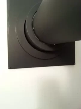

Anyway,I noticed a gap about 1/4 inch that goes about halfway around the collar of the pipe through the wall and can see a small amount of daylight on the other end.
I figured I could just seal it on the inside with some gasket or hi temp silicon(webby mentioned silver silicone for the outside to match).However,I spoke to the installer today for the first time since and brought it up,he said it is designed that way for airflow and he couldn't recommend sealing it up.
I'll attach some pictures again and am just asking for your thoughts.
How much cold air seepage am I looking at if I leave this open?Water and insect/rodent entry point?
The pipe passes through cinder block wall and has a pretty good clearance I can see they put around it.
Thanks!

Honestly that does not look like the right part there should never be that much of a gap. And no you do not need airflow there. Make them fix it.

I was hoping that wasn't going to be the answer.So now what is my leverage or how do I ask again since he already claims that's the design and he couldn't be responsible if I changed it?He basically already indicated there is nothing wrong.
He is wrong. That is not right! You should not see daylight thru this. You will have air pouring thru there come bitter cold winter. Sorry but this is where you are gonna have to be the bad guy and tell him what he does not want to hear.......fix this. If this is the "system" he uses then tell him it is unacceptable and he will need to fix it. Never give them a chance to back out by saying things like, can you fix this? You need to say instead, fix it please, it is unacceptable to me.
Realistically......he knows this is not right, I doubt he argues much. He needs to do this right. You have a beautiful home and stove, you should not settle for that kind of work.

call the chimney manufacturer
I Agree with the others something is not right I'm pretty sure you don't want a gap running through your wall. Calling the manufacturer is a good idea they should be able to help you get the right stuff.
Reactions: drstorm
No they should give him the info he needs to make this hack fix the job he screwed up. Guys like that make the rest of us look bad. They obviously take no pride in their work
That's what I'm getting at. He should not have to fix it himself. The installer should do it. The manufacturer can see what was used and what was not used on this install and tell the homeowner what the installer needs to fix.
Ahhh I thought you were saying they could get him the right stuff o fix it himself sorry.
No I agree with you the installer needs to fix his screw up. That's what he was paid for now he has to make it right.

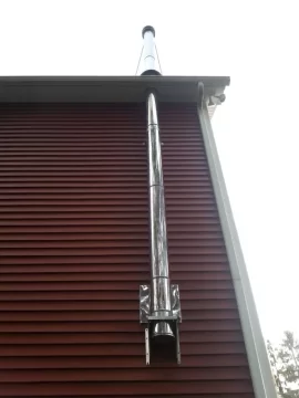

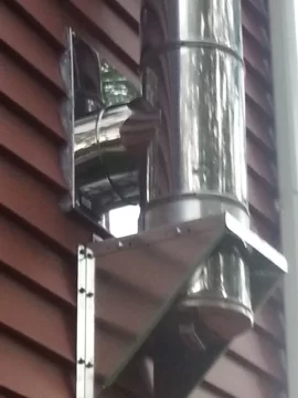

Aside from the incorrect installation/air gap issue... Am I seeing a 1" thick bead of silicone caulk on lap siding? If so it really needs to be removed and properly trimmed in, that will not last. I sure hope the guy put it in without a permit, because if an inspector passed this install you have two inept people involved.
I see no obvious code violations at all so we can see no reason for an inspector to fail it. Yes it is a crappy install and it needs fixed but I cant see any reason it would be unsafe. And inspectors only check for code nothing more. And in my experience they are not even all that good at that.
Well,I spoke with 3 different people today at different offices for this dealer.They all claim this is how every install looks and it's a duravent design.They even offered to bring out a duravent rep to explain it.
If that is the way their products are designed there is something seriously wrong. We stopped using simpson products because of poor fit and finish but that is way beyond anything we ever saw from them.

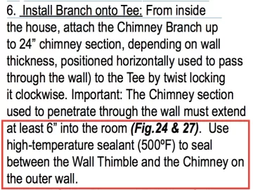

Duratech installation instructions state:

Though not required, on a yurt installation we did we also put a storm collar on the outside and siliconed it into place. The yurt has no eaves leaving this area quite exposed to rain and weather. The installation was done 10 years ago and is still leak free including no air leaks.
Reactions: BigFir
Good work BG, it does not appear to enter 6". But if it did, would that gap be taken up? Not to sure if it would make a difference. Just another flaw with the install?
The interior gap doesn't matter as far as air leaks go if the exterior pipe is properly sealed as directed. My guess is that it's there to avoid scraping the paint off the branch pipe to the tee? It looks like a bead of black silicone could be applied there if it bothers you.
That gap is way to large to be covered with caulk. Yes it is typical to have a very small gap that needs a bead but that is way more than normal.

No there is no air space in double wall chimney to pull air through. And honestly pulling outside air in around the chimney is a bad idea. You would be cooling the flue gasses by pulling cool air around the pipe. That is bad especially on a stove like yours that already runs pretty cool.
Am I back at square one of a bad install or is there any sense to this?
Yes it is a bad install. It honestly looks like they used the wrong component there that gap is way to large.
