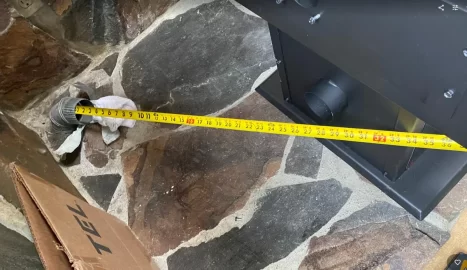

What is typically used to connect air intake with the stove?
[Hearth.com] Air intake connection
Metal flex dryer duct works fine. Or it can be hard connected with rigid pipe and elbows.
