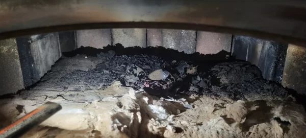

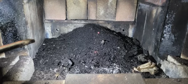

Finally got the chimney swept. First pick is what was sitting on top of the thermal blanket. Second picture is the firebox after I removed the tube and blanket and swept he chimney. It definitely needed cleaning.
After cleaning I put the blanket and tubes back in. I started a fire just with cardboard to see how it would go. Box filled up with smoke again. I took the blanket and baffle boards out today and did a fire with cardboard again and it still filled the box with smoke. I'll get in the fireplace and shine a light in the chimney tomorrow to see if there is any obstruction but I doubt it since the sweep went up the chimney with no resistance.
