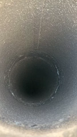

Here’s a picture of my pipe. It’s about 17 feet tall. But I seem to have plenty of draft. The flames and heat get pulled up the flu with an obvious visual in audible sound
