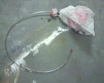

I have a chimney top damper that works pretty well. When I'm not using the fireplace for a few days I plug the bottom of the flue with a homemade chimney balloon. I got a short length of plastic tubing, slipped one of those thick kiddie punch balloons over the tubing and taped on tight with electrical tape, then slipped a trash bag over the balloon (to protect it from abrasion/sharp edges) and taped that on the tube with electrical tape. Stick the trash bag covered balloon in place just above the firebox, blow through the open end of the plastic tubing to inflate the balloon inside the trash bag until it is snug in place. Then I stick a wire nut in the open end of the tube to hold the air in the balloon.
Works great, costs less than $5, and takes 2 minutes to install, 30 seconds to take out.

Dave,
I've got to see this! Can you post a photo?
Shari
Here you go Shari.....
Dave

Dave,
Now that is innovative! You have to patent that and give it a nifty name!
