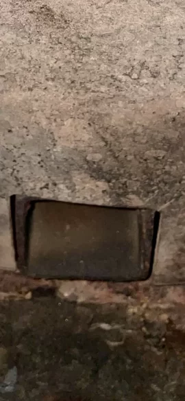

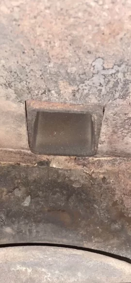

Has anyone seen this?

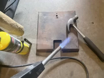

I got a bottle of Map Gas and my hammer and just started heating and beating! It worked! Before you could Not see the edges of the pellet drop chute. But now you can! Now it looks like it should!! $10 fix !!
Map Gas from ACE hardware for 5300 Deg F
