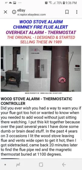

anyone know anything like this that's more commercial

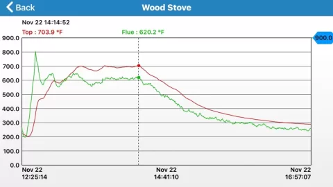

It's interesting that except for the beginning of the burn, the stove top temp exceeds the flue temp. Interesting to me, anyway, I guess I should've known.
Yes, it's a good illustration of how the stove works and why I only go by probe flue temp (and not stove top) for timing of the air control closure. I do close down the air sooner though. Usually I have the air closed around 50% by a 400F flue temp.
On the other hand, for the large majority of the burn, when he's cruising at flue probe temp of X, stove stop will be X+100. Stove top temp is an important parameter.

Not so, it's not a workaround, it's running the stove efficiently. Starting to close down the air around 400 for our stove is done with a visual check that secondary combustion has started. If the air was closed all the way down at that point the fire might start smoldering. One's eyes are the most important instrument here. Usually with dry softwood I am turning down the air fully within the next 5-10 minutes. Burning hardwood means letting it go a little hotter and longer, but not a lot. After 10 yrs of operation I know our stove well. Looking at the stove top temp is unnecessary. As long as I keep the flue temp under 600F it's not overfiring or overheating. I know that the stove top will be about 100-150º over the flue temp.
