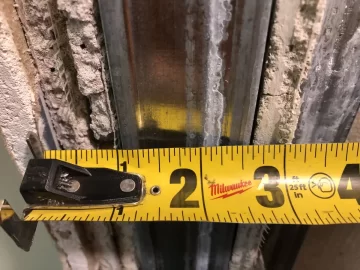

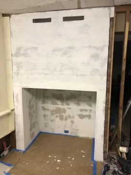

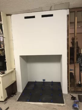

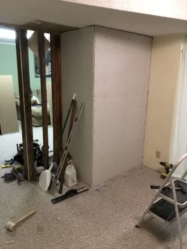

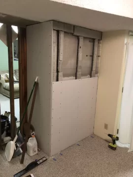

Ended up ordering a gallon of Silacote paint with a quart of their primer. I mixed half the gallon of paint with the quart of primer for the first coat (this thinned it out and let it soak in more). Second coat was just the paint. Enough is left for touch-up.
The alcove walls are done, chimney is connected, flashed, supported, and terminated top & bottom. Slate tiles are in, just need to grout & seal. Next Sunday (11/20) the wood stove should go in - it's in the garage.
All combustibles (wood, paper surface of drywall) ended up at or exceeding the "combustible alcove" clearances, plus there's the 1/2" Durock with 1" to 2-5/8" space between them that is within the "non-combustible alcove" clearances listed on pg 13 of the Lopi Evergreen manual. Behind the Durock, there's a 1-5/8" 20g steel stud, then another 1" of space achieved by doubling up Durock scraps before the drywall is put in place (so over 3" from the hottest wall surface facing the wood stove to the drywall). The white paint should also help reflect a lot of the heat into the room instead of soaking it up.
I framed in the vents at the top with metal studs, and we ordered grate covers that have a tension spring in them to keep them in place. The dampers were removed so they're always open. The vents should allow the stove to really heat the room through convection even though it's in an alcove - the hot air will just get sucked out the top vents even when the power is out.

Thanks for the update and visuals. Note that the air gap is not effective unless it is ventilated by at least a 1" gap a the bottom for air to enter and at the top for air to exit. A sealed, static air cavity is not the same WRT protection. It needs to be ventilated to allow the free convection of air.
s0ulP@tch
Nov 26, 2020
41
Oregon
Will that be a problem considering all of the clearances to combustibles will still be met regardless?
Edit: I should note that the inspector already approved the current layout without venting - I specifically asked about needing it. Keep in mind that if the inner Durock sheathing were removed, the clearances to combustibles would be within specs as they sit right now.
