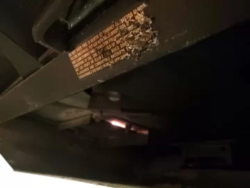

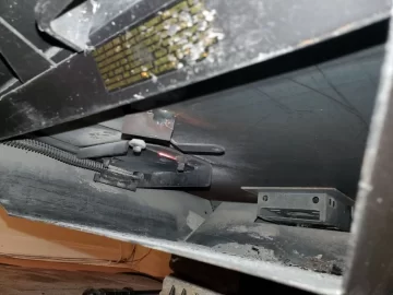

I might want to get rid of my ash door in my stove. i know these things don't seal perfectly since there is no gasket. is ther a blanking plate that can be bolted on after removing the ash door?
See pics

I'd leave it in place in case the stove is ever sold. In this case, it looks like there are some coals or clinkers caught at the edge of the trap door. That's a common problem. Good for you spotting it. Clean it well of all ash and coals and verify it is shutting tightly. Then let that pocket between the bricks fill up with ash and don't use it. There will be no leakage then.
Had that happen to me on my PE Spectrum which is one of the reasons I never use that ash trap. In my case I removed the firebricks around the ash trap, vacuumed the steel floor fully, cleaned the ash trap in and out, closed it several times to ensure it sealed perfectly and fully. The ash trap disposal system IMHO is more trouble than anything else, PE should remove it and offer it as an option only to those he really want it.
