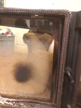

Can anyone tell me if the interior gasket on the picture attached would cause issues. I just had this installed a month ago and noticed that the gasket was folded towards the inside. My burn times have been very short, flames for maybe 3 hours on a full load then coals / embers.
Both sides are folded up like this.

I don't see a serious issue with the glass gasket. How is the door seal when doing the dollar bill test?
The glass is smoked up there, which could indicate a leak. Was that a long split too close to the glass, where the other black spot is?
Actually, the glass looks pretty bad all over. How dry is your wood?
The smoke on the glass looked like a log end too close to the glass. The rest of the glass looks like it just hasn't been cleaned in a while.

You can check that glass gasket with a candle, incense, cigarette, etc. Just move around it and see if the flame or smoke gets sucked into the stove.
